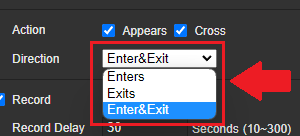

Step 4: In the Direction menu, choose how the rule will be triggered if the object enters only, exits only, or enters & exits a set region.
