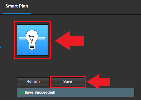

Step 3: Click on the IVS option in the Event menu then click on the ( + ) icon to add the rule. Select Tripwire from the Rule Type menu.  Then click on Draw Rule to begin drawing the tripwire line on the interface. Use your mouse to draw a line in the interface. Right click on the interface when done to set the line.

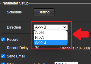

Step 4: In the Direction menu, choose which direction the object will be going for the tripwire to be triggered.
Note: A->B =  Enters, B->A = Exits, A<->B = Enters or Exits. If you would like an snapshot of the event to be emailed, click Send Email. If a PTZ preset will be activated once the rule is triggered, click PTZ, then select Preset from the dropdown menu.
Step 5: Ensure the Record option is enabled. If you would like the siren or warning light to be activated once the rule is triggered, select Siren Activation and Warning Light. Click Save to save and apply the settings.
