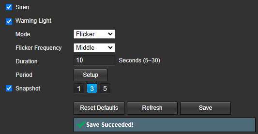

Step 2: Click on Setup>>Event and setup a detection modes. Motion detection will be enabled by default, however, for more information on how to setup AI features, such as IVS , click here.
Step 3: In the setup menu, enable the warning light and siren options. This will allow the camera to activate the deterrents once an event is detected. Click Save to apply the settings.
Siren: This checkbox allows the camera to activate the alarm once an event is detected.
Play Duration: The amount of time the siren will sound.
Warning Light: This checkbox allows the camera to activate the red/blue LEDs once an event is detected.
Mode: The current mode of the warning light LEDs will be set to flicker only.
Flicker Frequency: The intensity of the warning light LEDs after they are activated. Can be set to high, medium, or low depending on the user’s preference.
Duration: The amount of time the warning LED will flash.
Period: Schedule a time in which the deterrents will apply.

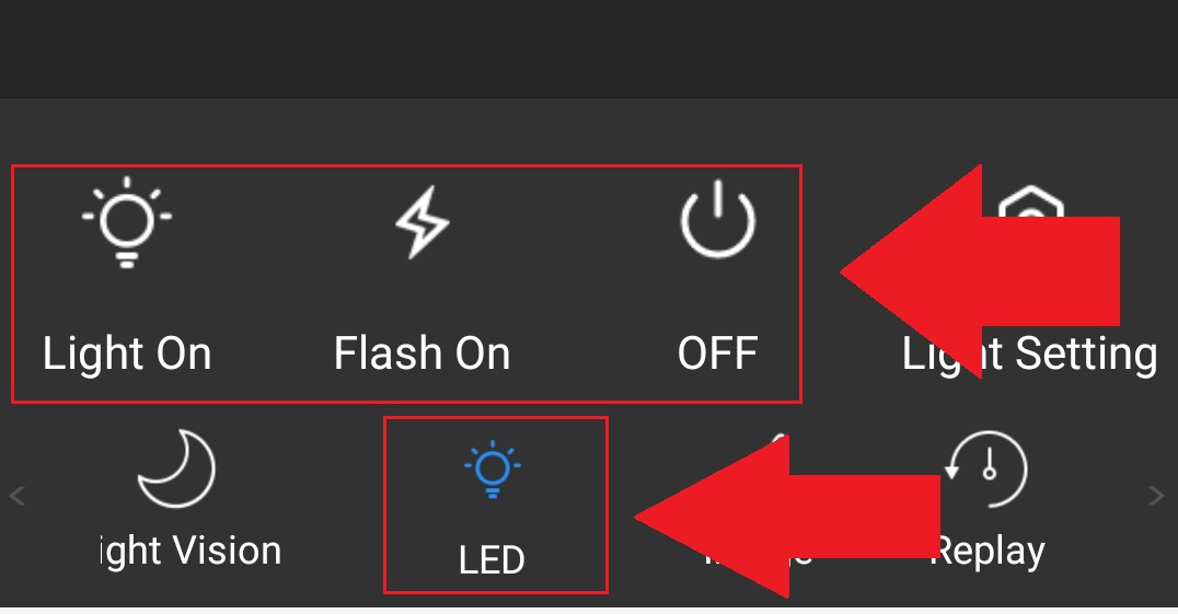

How To Enable or Disable Using Amcrest View Pro
The deterrents can also be manually enabled or disabled using the Amcrest View Pro app on your mobile device. To enable the red/blue LEDs on your device, click the LED option in the app and use the provided options.
