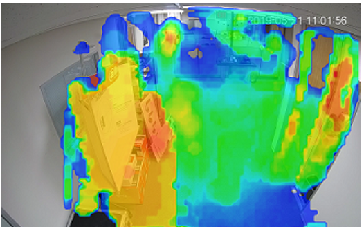

Heat Map is a tool used to determine the overall crowd flow (density) over a certain amount of time in a specific area. Heat map provides a color-coded layout of the density with red being the highest level to blue which is the lowest level.

Heat map reports provide a color-coded image of the heat map reporting over a specified period. Please note, a microSD card must be inserted in the camera for a report to be retained. To view a heat map report, click the Report option located in the AI menu and select Heat Map.
Select a date & time of the report, select a start and end date and time of the report in the interface. The report can show the density of people in the area or the amount of time the people in the area were detected. If using people number, enter a threshold which will be shown, if using time, enter the amount of time (in minutes) the report will apply. Click Search to view the report.
