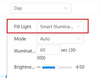

Step 1: Ensure your computer is on the same network as the camera and log into the web UI. For more information on accessing the web UI, click here.
Step 2: Navigate to Setup>>Configuration>>Illuminator and select the Fill Light drop down menu.
Step 3: By default, the camera will be set to Smart Illumination. Smart illumination will have the IR LEDs illuminate at night, however, will flash the red/blue LEDs once a motion even is detected. Select a different night vision setting, such as IR Mode (activates IR LEDs for B/W night vision) or White Light Mode.
Step 4: Click Save to apply the new night vision settings to the camera.
Note: To disable night vision completely, access the Mode menu and select OFF. Click Save to save and apply the settings.
