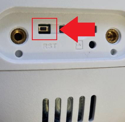

Step 1: Locate the reset hatch on the camera and remove the cover.
Step 2: Insert a pin or similar object to press the Reset button for 30 - 45 seconds allowing the camera to reset.
Step 3: Once the reset of the camera is complete, place the reset hatch back  and secure it to the camera.
