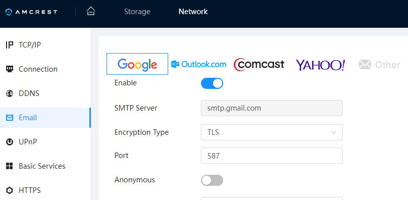

Step 1: Click on the Settings icon and select Storage.
Step 2: In the Network menu select Email and select your email provider, which in this case will be Gmail.
The preferred SMTP information will be imported into the interface, which is TLS (port 587), however, you can select SSL (port 465) as well if needed.
Password: *This should be your Gmail generated app password. **Please refer to Allow Less Secure Apps (Updated) section for more details.
• In Gmail, click the account avatar/icon picture located in the upper right of the window.
• Click the blue button that says "Manage Your Google Account"
• Once on the account setting page please click "Security"
• Click on App passwords
• Enter your email password, and click Next.
• Select an option from the provided drop down menus and select Custom. Enter a name for the authentication and click Generate.
• Google will provide a security password which must be entered into the device's Email Setup interface in the device's web UI.
• Navigate back to the web UI, and in the email interface, enter the app password provided by Google into the Password section.
Subject: Enter your subject line here. (Ensure attachment is checked so that you get snapshots in your email.)
Recipients: Enter the email address you would like to receive notifications at here and click Add to add it to the recipients' list. You must have added at least one email in this field to receive a notification. We recommend at least adding the sender address previously entered in the above field.
Health Email: This is a periodic email update from the camera set at different intervals defaulted at 60 seconds. This email alert will generate an update from the camera notifying you it’s still connected. If you were to not receive these emails the camera has lost connection with the network it’s connected to. (If you are receiving too many emails this is likely the cause, as "Keep Alive" should be unchecked if you do not wish to receive health updates from the camera every 1-3600 seconds.)
Sending Interval: This Interval value determines the time in between emails you will receive for motion detection alerts. (Longer intervals will make it so that you do not get spammed emails constantly.)
Step 3: Click Save. Click Test to test the connection. A test email will be sent to the email address you have entered.
