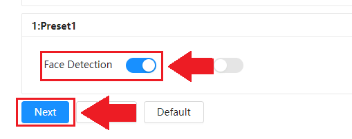

Step 4: Click +Preset and select the created preset. Select Face Detection, then click Next.

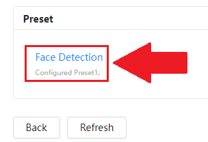

Step 5: Click Face Detection.

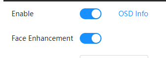

Step 6: The detection area (yellow square) will be set to full screen by default, however, you can use your mouse to modify the detection area if needed. Click Enable and select OSD Info to ensure the face detection overlay is on the live view screen.
Note: Additional face optimization options, such as face enhancement can be enabled.
