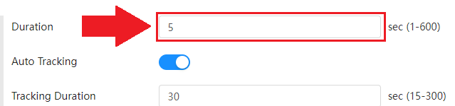

By default the rule will be set to trigger if multiple people are within the detection area for a duration of 5 seconds. However, you can adjust the duration if needed from 1-600 seconds.
Note: This camera also supports Auto Tracking. This will allow the camera to automatically track the object until it is no longer visible in the detection area or for a duration of 15-300 seconds.
