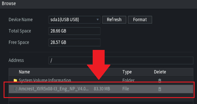

Step 1: Extract the downloaded firmware file onto the USB drive. The firmware file is usually in a .bin format. Safely connect the USB drive to your Amcrest DVR's USB port.
Step 2: From the main menu click on Maintain. Click on Manager>>Update, then click Update to locate the firmware file.
Step 3: Locate the firmware file on your USB drive and click OK.
Your DVR will restart once the upgrade is complete.

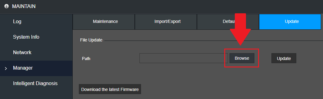

Method 2: Updating Firmware via Web UI
Note: Download the latest firmware file for your Amcrest DVR (amcrest.com/firmware) to your computer. Ensure the DVR and computer are on the same network while upgrading.
Step 1: Open a web browser and access the web user interface (web UI) for your device. For more information on how to access the web UI, click here.
Step 2: From the main menu click on Maintain. Click on Manager>>Update, then click Browse to locate the firmware file.

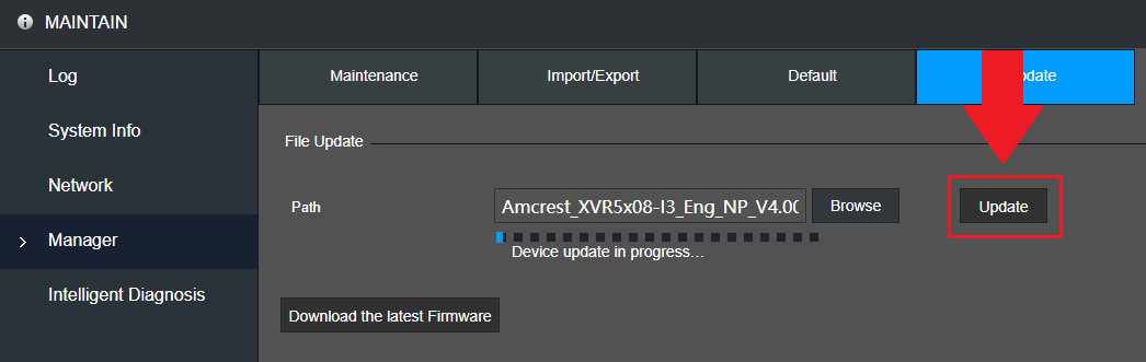

Step 3: Once the file is selected and imported into the interface, click update to upgrade the DVR.
