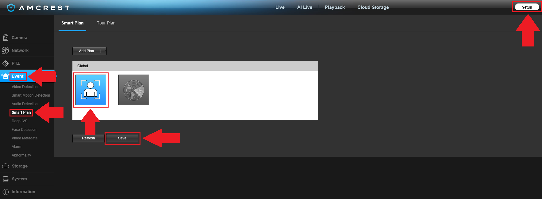

Step 2: Click on Setup>>Event>>Smart Plan and ensure a Face Detection smart plan is enabled. Click Save.

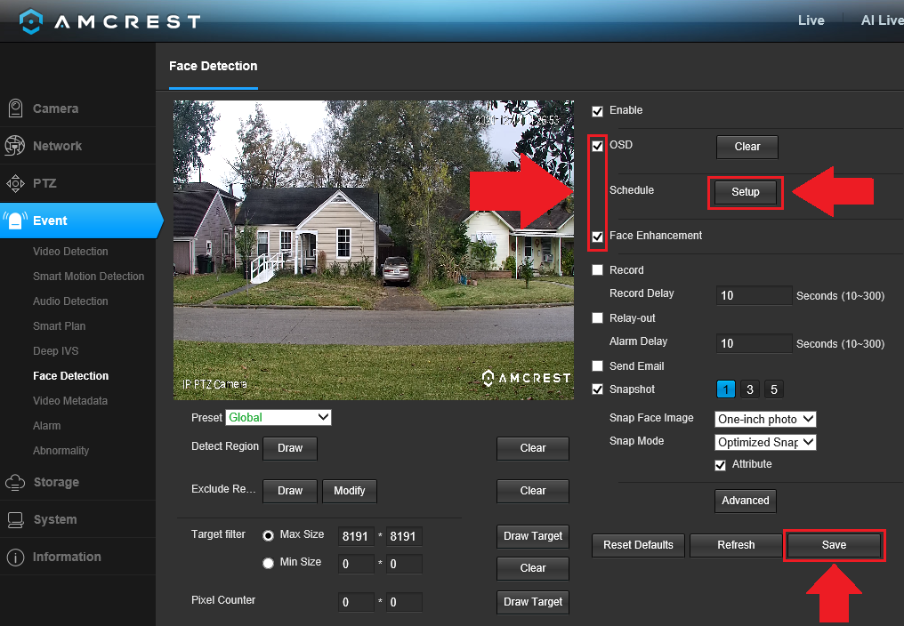

Step 4: Enable OSD to allow face detection OSD information to be displayed in a face statistics overlay. Click Setup to set a schedule for the feature (if any) and click Save.
Note:  If needed, click on the Face Enhancement checkbox to enhance the accuracy of the face detection image.

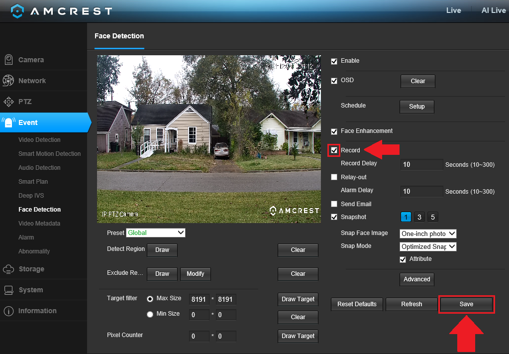

Step 5: Click Record to allow the device to retain face detection events. Click Save.
