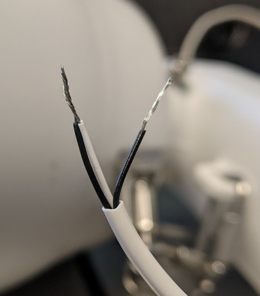

Step 1: Use a pair of scissors to cut and expose the bare audio wires of the microphone. The black and white wires will be the audio cables of the microphone. The black wire will be the ground.

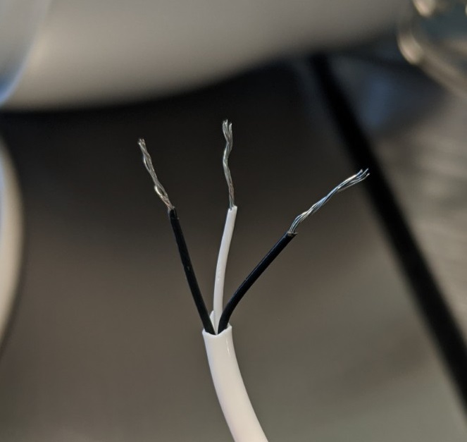

Step 2: Twist and connect the black and white wires of the microphone together.

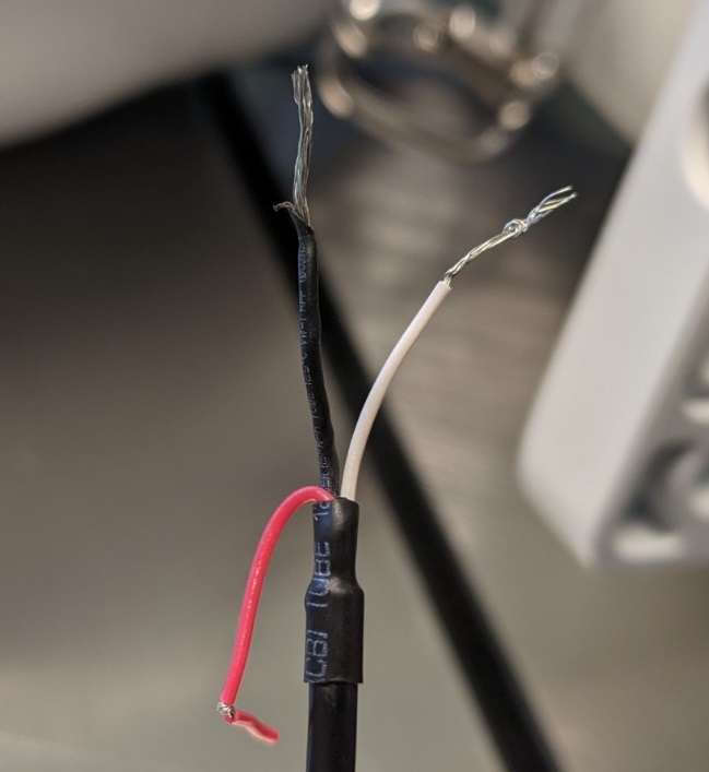

Step 3: Locate the audio connections on the dongle wire connection of the camera.

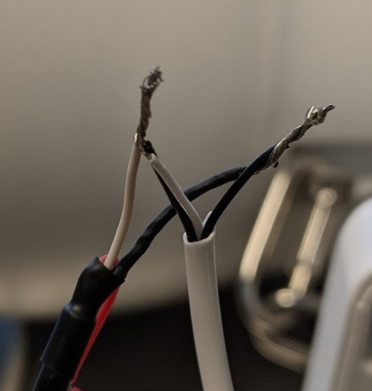

Step 4: Twist and connect the two audio connections previously made to the white audio in wire on the camera and connect the black ground wire to the black ground wire on the camera.
Note: Use a wire nut or electrical tape to protect the bare wires from corrosion or damage.
