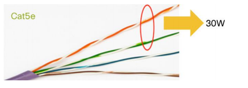

As defined in IEEE 802.3af and IEEE 802.3at, PoE delivers electrical power over two pairs out of the four twisted pairs of cable in Class D (also known as Cat5e) or better, cabling as specified in ISO/IEC 11801:1995. A PSE uses only signal pairs, the pairs 1, 2, and 3, 6, to transport power from the PSE to the PD and leaves the spare pairs, the pairs 4, 5, and 7, 8, idle. This architecture can deliver up to 30W per port.

| Maximum power per PSE port | 15.4W | 30W |
| Maximum power to PD | 12.95W | 25.5W |
| Twisted pair used | 2-pair | 2-pair |
