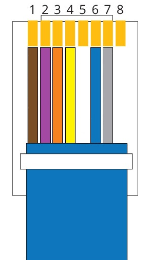

However, if the connection becomes corroded or weather damaged, this may propose a need to replace the Ethernet port on the camera. The Ethernet wiring on the camera side differs from that of a typical RJ-45 Ethernet cable's wiring.
Below is a representation of how to apply these concepts to a typical RJ-45 connection.
Below is a description of the basic functionality of each wire associated with the Ethernet port pins on your camera:
| Pin | Name | Description |
| 1 (Brown) | TX+ | Tranceive Data+ |
| 2 (Purple) | TX- | Tranceive Data- |
| 3 (Orange) | RX+ | Receive Data+ |
| 4 (Yellow) | N/A | N/A |
| 5 (N/A) | N/A | N/A |
| 6 (Blue) | RX- | Receive Data- |
| 7 (Grey) | N/A | N/A |
| 8 (N/A) | N/A | N/A |

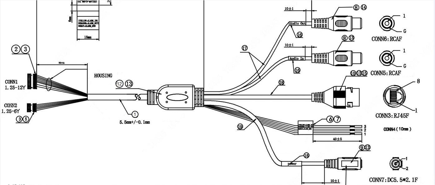

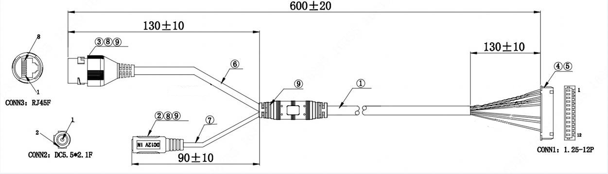

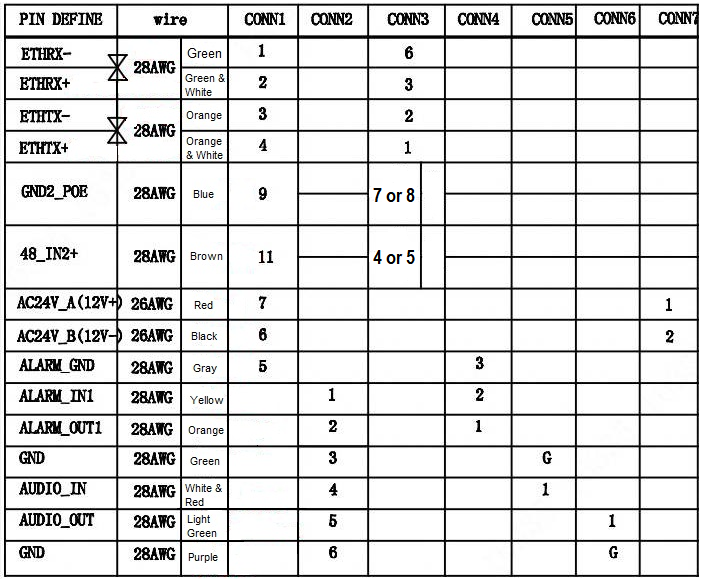

Some other cameras may vary in their pin layout. Below is a description of the basic functionality of each wire associated with the Ethernet port pins these cameras:
Cameras with external mic/speaker output wiring, such as the IP8M-2493E, etc, the diagram may be different. Please refer to the information below for more details
