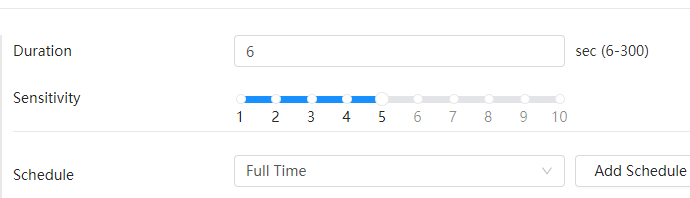

Step 4: Click Add Rule and select Parking Detection from the dropdown menu. Use your mouse to draw a detection area on the interface. The default duration in which the object can stay in the detection area is 6 seconds, however, can range up to 300 seconds if needed.
