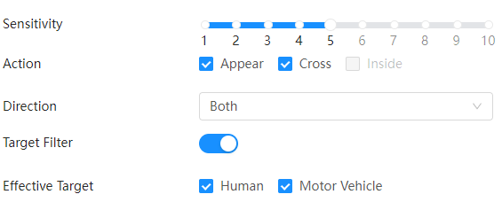

Step 3: Click Next. Select IVS from the Smart Plan menu and click Next.
Step 4: Click Add Rule and select Intrusion from the dropdown menu. Use your mouse to draw a detection area on the interface.
Step 5: In the Action menu, set the rule to trigger if the object appears or crosses the detection area. An option effective target filter can be set that will allow the rule only to trigger when a human or vehicle crosses the area.
Step 6: Click Playback to retain events to a microSD card. This will allow you to view IVS events in the playback menu. Select any additional options, such as a siren, which will allow the camera to produce an audible siren, or email to send a notification of the event to an entered email address. For more information on how to setup email alerts, click here. Click Apply when finished.
