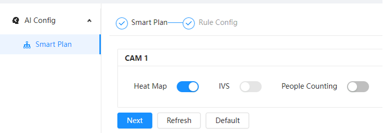

To begin setting up heat map, select a smart plan mode and enable the Heat Map option located in the Smart Plan menu and click Next.
Note: Heat map and people counting smart plans can be activated simultaneously if needed.

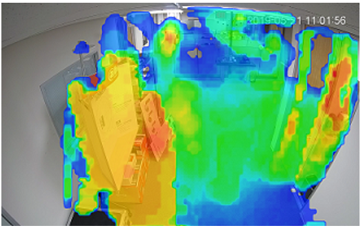

Viewing a Heat Map Report
Heat map reports provide a color-coded image of the heat map reporting over a specified period. Please note, a microSD card must be inserted in the camera for a report to be retained. To view a heat map report, click the Report option located in the AI menu and select Heat Map.
Select a date & time of the report, select a start and end date and time of the report in the interface. The report can show the density of people in the area or the amount of time the people in the area were detected. If using people number, enter a threshold which will be shown, if using time, enter the amount of time (in minutes) the report will apply. Click Search to view the report.
