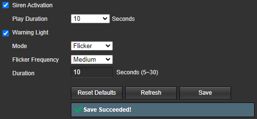

Step 3: In the setup menu, enable the warning light and siren options. This will allow the camera to activate the deterrents once an event is detected. Click Save to apply the settings.
Siren Activation: This checkbox allows the camera to activate the alarm once an event is detected.
Play Duration: The amount of time the siren will sound.
Warning Light: This checkbox allows the camera to activate the white light LEDs once an event is detected.
Mode: The current mode of the warning light LEDs will be set to flicker only.
Flicker Frequency: The intensity of the warning light LEDs after they are activated. Can be set to high, medium, or low depending on the user’s preference.
Duration: The amount of time the warning LED will flash.
