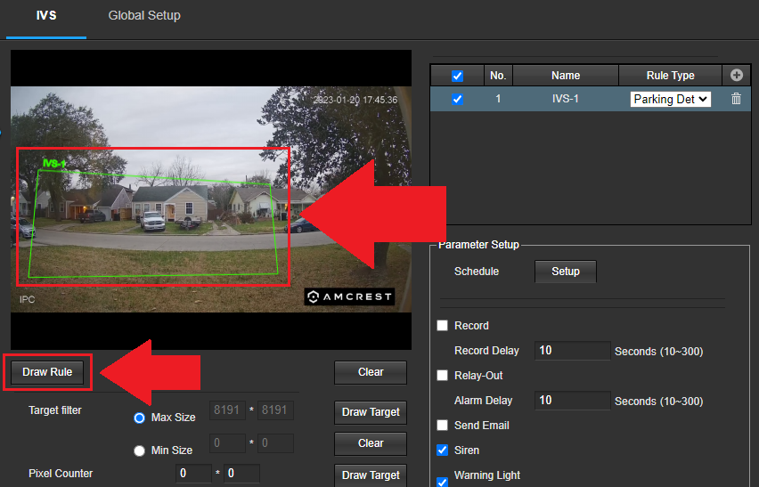

Step 3: Click on the IVS option in the Event menu then click on the ( + ) icon to add the rule. Select Parking Detection from the Rule Type menu. Then click on Draw Rule to begin drawing the detection area on the interface. Use your mouse to draw an area. Right-click on the interface when done to set the area.
This rule requires you to draw at least a four-point area on the interface to function. To draw an area, click the mouse on the interface and move it down or up to create a line. Once the line is created, move the mouse left or right to create another line and repeat the process. Right-click on the interface to set the area on the screen then left-click on the interface when done to set the area.

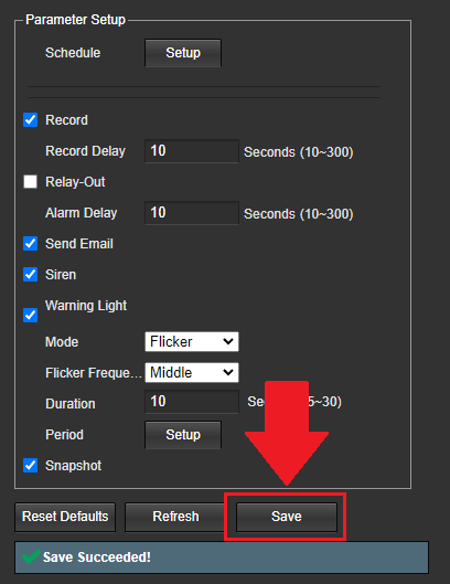

Step 4: Enable the Record option as well as any other options you would like to set for this option and click Save to save and apply the settings.
