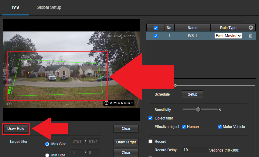

Step 3: Click on the IVS option in the Event menu then click on the ( + ) icon to add the rule. From the drop down menu, select Fast-Moving. Click on Draw Rule to begin setting a detection area. Use your mouse to draw an area on the interface.

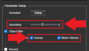

Step 4: Use the sensitivity slider to adjust the overall speed threshold of the rule. An optional object filter can be set that will allow the rule only to be triggered if it detects an effective object such as a human or vehicle. You can choose both filters if needed.

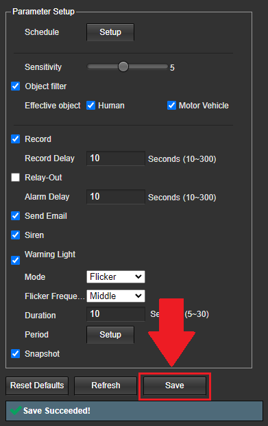

Step 5: Enable the Record option as well as any other options you would like to set for this option and click Save to save and apply the settings.
