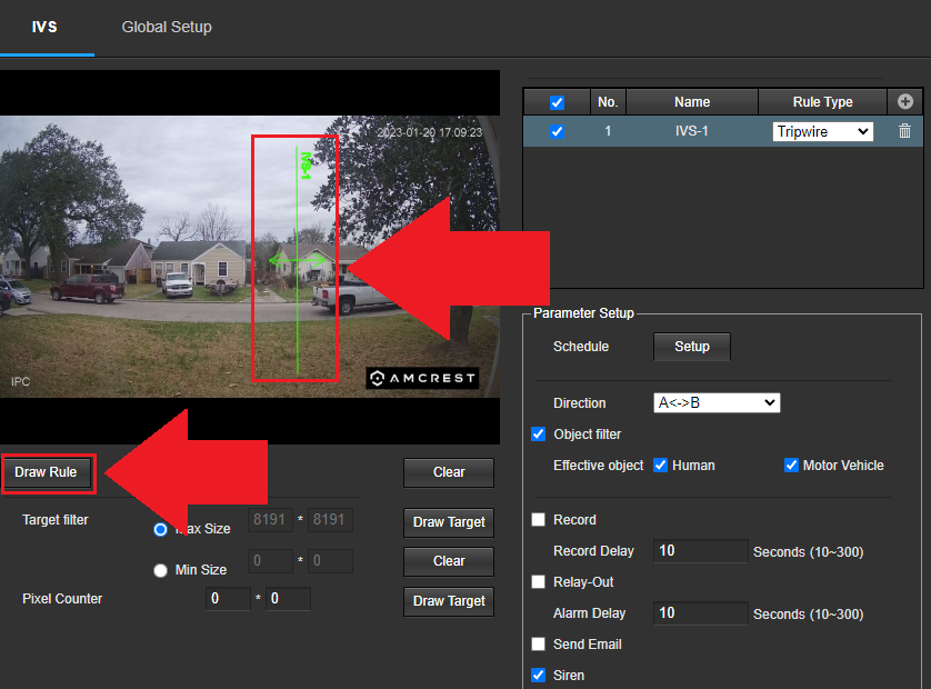

Step 2: In the web UI, click on Setup>>Event>>Smart Plan. Click on the IVS icon and click Save.
Note: If a Smart Plan is not enabled properly on your camera IVS features will not work. Please make sure to enable the Smart Plan feature before continuing.
Step 3: Click on the IVS option in the Event menu then click on the ( + ) icon to add the rule. Select Tripwire from the Rule Type menu.  Then click on Draw Rule to begin drawing the tripwire line on the interface. Use your mouse to draw a line in the interface. Right click on the interface when done to set the line.

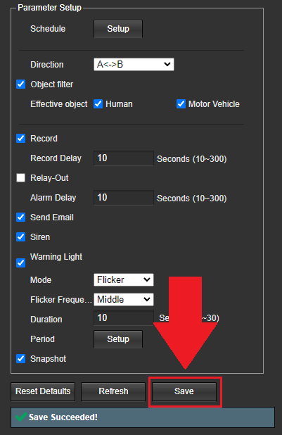

Step 5: In the Direction menu, choose which direction the object will be going for the tripwire to be triggered. An optional object filter can be set for tripwire that will allow the rule only to be triggered if it detects an effective object such as a human or vehicle. You can choose both filters if needed.
Note: A->B =  Enters, B->A = Exits, A<->B = Enters or Exits.
Step 6: Enable the Record option as well as any other options you would like to set for this option and click Save to save and apply the settings.
