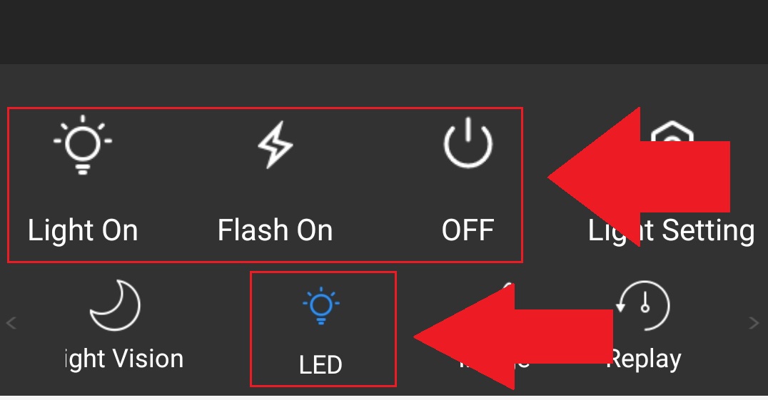

How To Enable or Disable Using Amcrest View Pro
The deterrents can also be manually enabled or disabled using the Amcrest View Pro app on your mobile device. To enable the white light LEDs on your device, click the LED option in the app and use the provided options.
