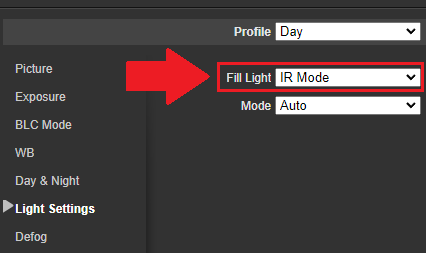

Step 1: Ensure your computer is on the same network as the camera and log into the web UI. For more information on accessing the web UI, click here.
Step 2: Navigate to Setup>>Configuration>>Light Settings and select the Fill Light drop down menu.
Step 3: By default, the camera will be set to IR Mode. Select a different night vision setting, such as White Light (activates white light LED for full color night vision for Smart Illumination, for smart dual illumination). Smart illumination will have the IR LEDs illuminate at night, however, will illuminate the white light LEDs once a motion even is detected.
Step 4: Click Save to apply the new night vision settings to the camera.
Note: To disable night vision completely, access the Mode menu and select OFF. Click Save to save and apply the settings .
