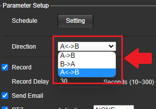

Step 4: In the Direction menu, choose which direction the object will be going for the tripwire to be triggered.
Note: A->B =  Enters, B->A = Exits, A<->B = Enters or Exits. If you would like an snapshot of the event to be emailed, click Send Email. If a PTZ preset will be activated once the rule is triggered, click PTZ, then select Preset from the dropdown menu.
