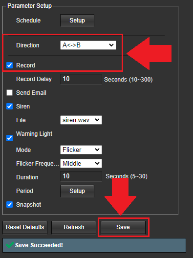

Step 4: In the Direction menu, choose which direction the object will be going for the tripwire to be triggered, enable the Record option, and click Save.
If you would like the siren and the spotlight option to be activated when the rule is triggered enable the Siren and Warning Light options.
The tripwire rule has now been properly set up for your camera. The target filtering can be used to refine the set rule however for an optimal experience it is highly recommended to leave these settings as default. All IVS data can be viewed in the Playback menu if a microSD card has been installed, emailed.
