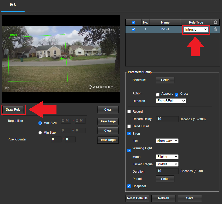

Step 3: Click on the IVS option in the Event menu then click on the ( + ) icon to add the rule. Select Intrusion from the Rule Type menu.  Then click on Draw Rule to begin drawing the detection area on the interface. Use your mouse to draw the area. Right-click on the interface when done to set the area.
Note: This rule requires you to draw at least a four-point area on the interface to function. To draw an area, click the mouse on the interface and move it down or up to create a line. Once the line is created, move the mouse left or right to create another line and repeat the process. Right-click on the interface to set the area on the screen then left-click on the interface when done to set the area.

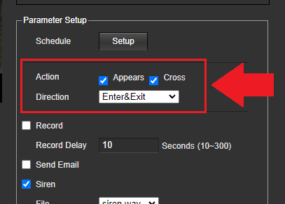

Step 4: In the Direction menu, choose how the rule will be triggered if the object enters only, exits only, or enters & exits a set region.

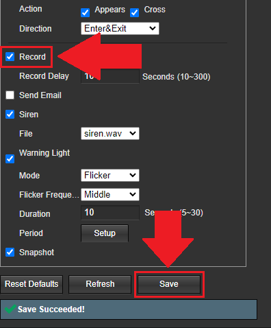

Step 5: Enable the Record checkbox to record the event. Click Save when done.
If you would like the siren and the warning light to be activated when the rule is triggered enable the Siren and Warning Light options.
The intrusion rule has now been properly set up for your camera. The target filtering can be used to refine the set rule however for an optimal experience it is highly recommended to leave these settings as default. All IVS data can be viewed in the Playback menu if a microSD card has been installed, emailed.
