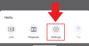

Step 1: Open the Helix Pro app and select the device settings option for your device on the home screen () and select Settings.

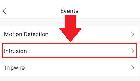

Step 2: Select Configuration Center, select events, and select Intrusion.

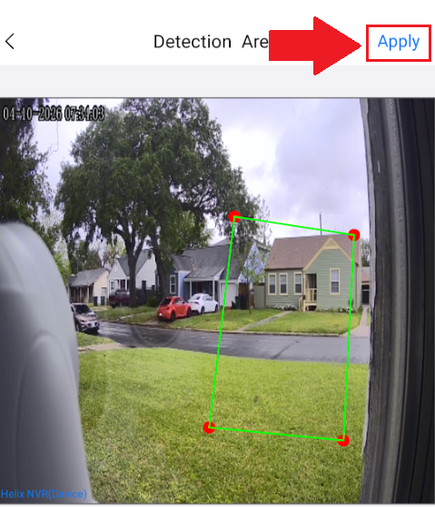

Step 3: Select a channel (if using an NVR) and tap Enable. Tap Detection Area. Tap Delete to remove the default detection area then use your finger to set a detection area on the interface. It is best to tap points on the screen to create an intrusion area. Double tap on the screen to set the area. Tap Apply.
