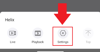

Step 1: Open the Helix Pro app and select the device settings option for your device on the home screen () and select Settings.

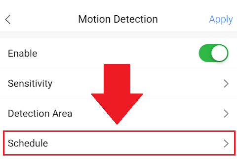

Step 2: Select Configuration Center, select events, motion detection, and tap Schedule.

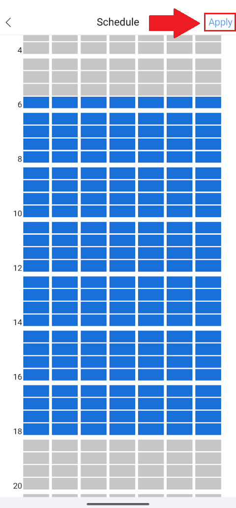

Step 3: The hours in the day will be represented on the left the days of the week will be on the top. Use your finger to set a schedule. For instance, if you want motion to only apply between 6pm - 6am throughout the week, make sure to enable the areas between 6 and 18 and tap Apply to save the schedule.
