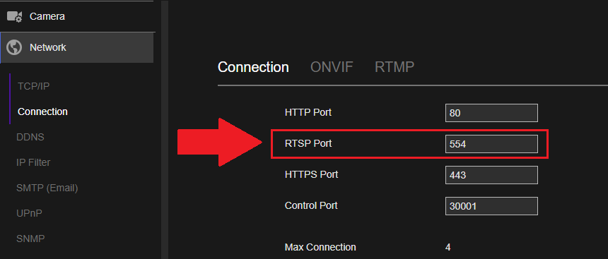

Note: The RTSP port can be modified in the web UI of your device if needed using a web browser. To update this port for any reason go to Settings>>Network>>Connection>>Port>>RTSP Port.
