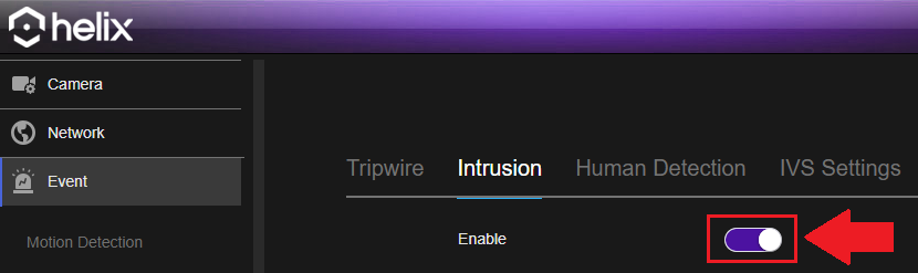

The intrusion function allows the camera to trigger an event if an object, such as a human, crosses a set detection area. After adding the detection area, the interface will show the rule as enabled, use your mouse to draw a detection area on the interface. For more information on how to setup the rule please refer to the information provided below.

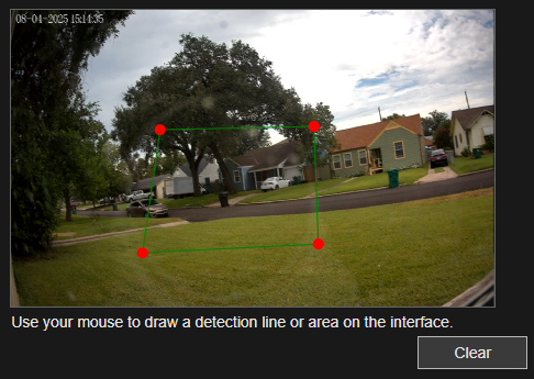

Step 2: Click on Settings>>Event>>IVS>>Intrusion and click Enable.
Step 3: Use your mouse to draw a detection area on the interface. By default, the detection area will be set to full screen, however, to adjust the area use your mouse to set a customized detection area. Click Apply. Click the Clear option to remove the detection line.
• Draw Enable or disable the ability to draw a detection line or area on the interface.
