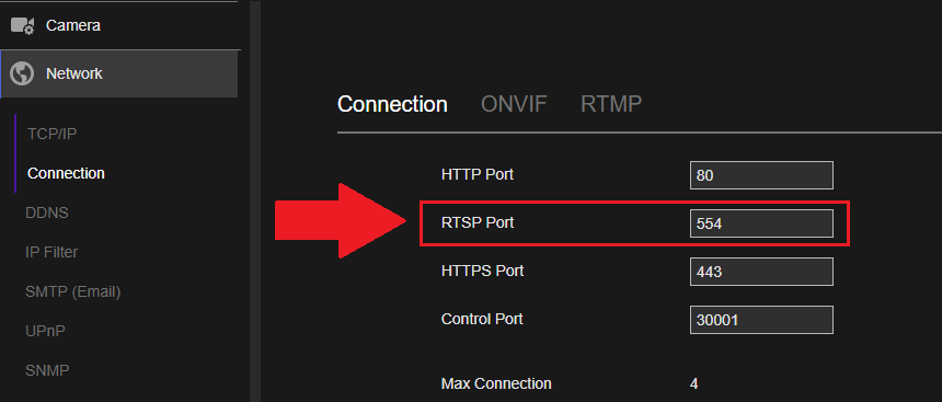

Some applications or viewing tools can use Real Time Streaming Protocol or RTSP to pull a device's stream. The default port number will be 554 and requires a specifically formatted URL. The RTSP URL format will be as follows:
Note: The RTSP port can be modified in the web UI of your device if needed using a web browser. To update this port for any reason go to Settings>>Network>>Connection>>Port>>RTSP Port
