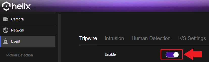

The tripwire function allows the camera to trigger an event if an object, such as a human or vehicle, crosses a set tripwire line. After adding the rule, the interface will show the rule as enabled, use your mouse to draw a detection line on the interface. For more information on how to setup the rule please refer to the information provided below.
Step 2: Click on Settings>>Event>>IVS>>Tripwire and click Enable.
Step 3: Use your mouse to draw a tripwire detection line on the interface. Use the directional dropdown menu to set which direction the object will be going for the tripwire to be triggered. It can be set left, right, or in both directions (A<->B). Click the Clear option to remove the detection line.
