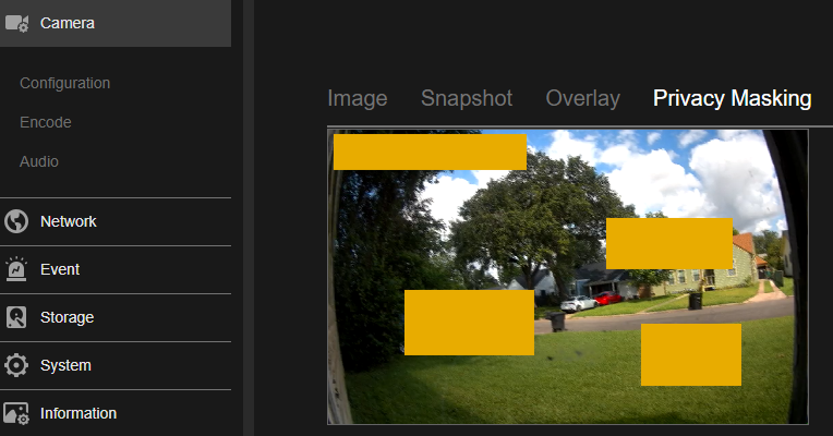

Step 2: Navigate to Settings>>Camera>>Configuration and select the Privacy Masking tab. Use your mouse to set a privacy block on the interface. A maximum of four privacy blocks can be set if needed.
Step 3: Click Apply to set the privacy masking blocks.
Note: To remove a single block, double click on the block and click Apply. To remove all the privacy blocks, click the Remove All option and click Apply.
