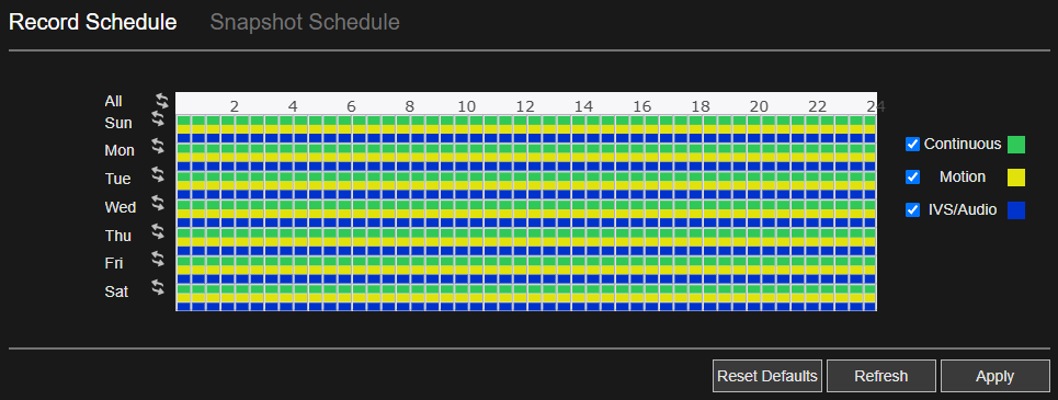

Step 2: Navigate to Settings>>Storage>>Schedule.
There are 3 record types:
Continuous: The camera captures all footage for the specified time period. Continuous snapshot schedules are represented by the color green.
Motion: The camera captures all motion detection events for a specified time period. Motion event schedules are represented by the color yellow.
IVS/Audio: The camera will capture all IVS and audio detection events. These record types will be represented as blue in the interface.

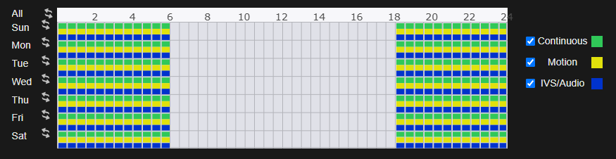

Step 3: To adjust a video recording schedule, select a record type then click and drag on the time bar for the desired date. To edit multiple days at once, drag the cursor further up or down to cover the other days. For instance, if you would like a rule to only apply from 6am till 6pm all week, click and drag the applicable area on the interface and click Apply.
A snapshot schedule can be modified similar to a recording schedule if needed in the Snapshot Schedule tab.
