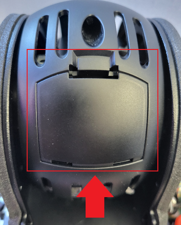

Step 1: Use the included torx wrench to remove the dome casing. Locate the hatch on the camera and remove the cover.

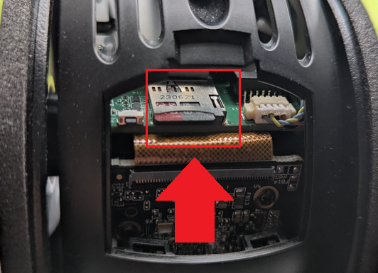

Step 2: Locate the microSD card slot and insert the card into the slot. Press in to lock it into place.
