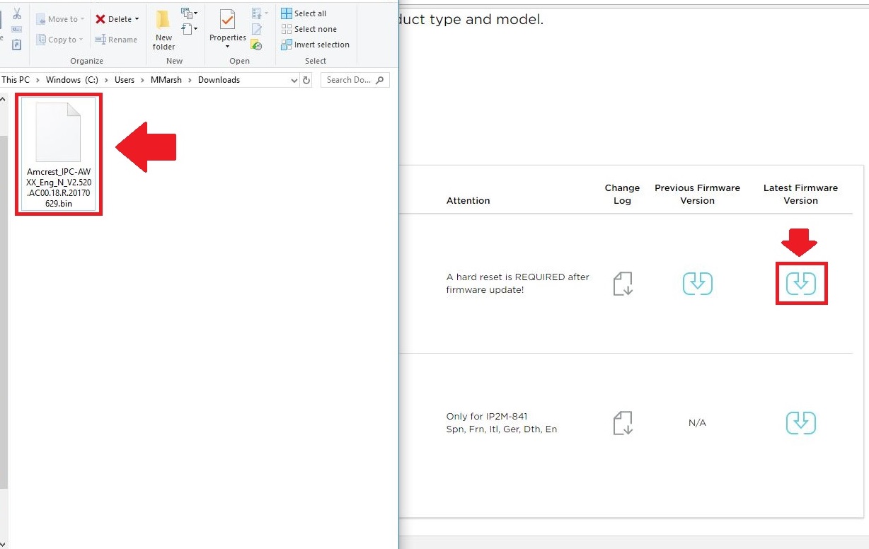

If you are operating on an older, or substandard version of firmware it can cause numerous security and other issues inside the camera. To access and download the most current firmware file for your device visit amcrest.com/firmware

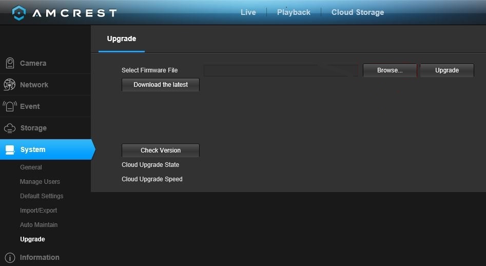

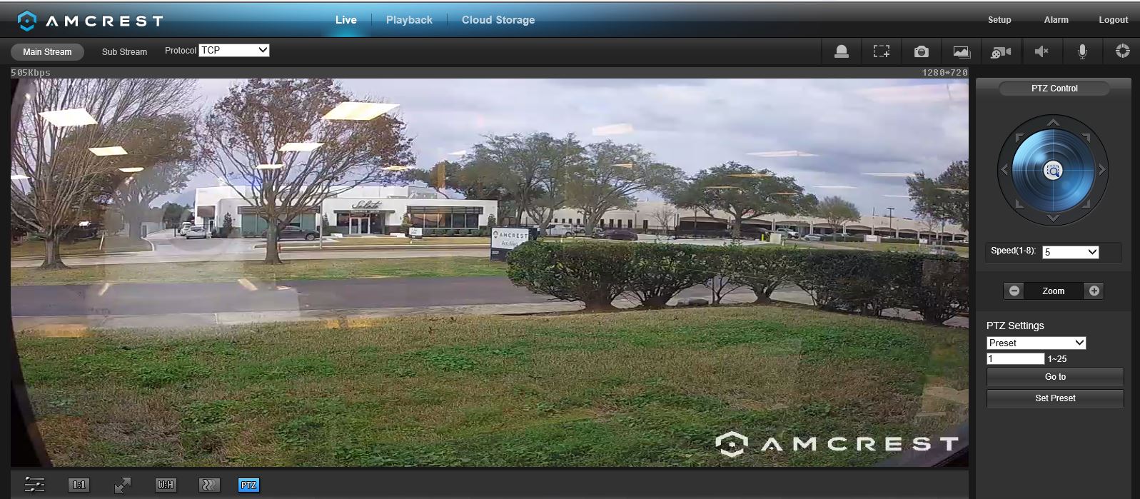

Step 1: To begin, access your camera's web UI via a laptop or PC. For more information on how to access the web UI for your device, click here
Step 2: In the web UI, please go to, Setup>>System>>Upgrade

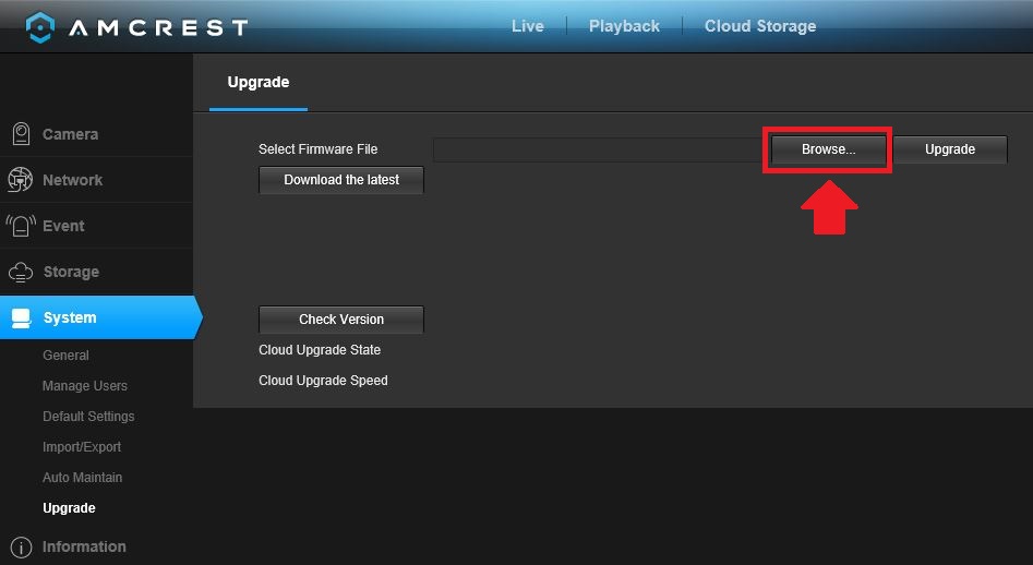

Step 3: Located the file (.bin) you just downloaded from the firmware downloads page. You can search for the file by pressing the "Browse" button.
The file (.bin) will be downloaded to the designated folder path set by the user.

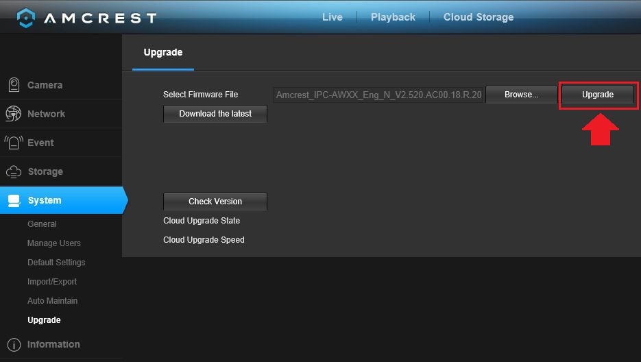

Step 4: Once your firmware has been loaded into the web UI, press "Upgrade" to start the upgrade process.

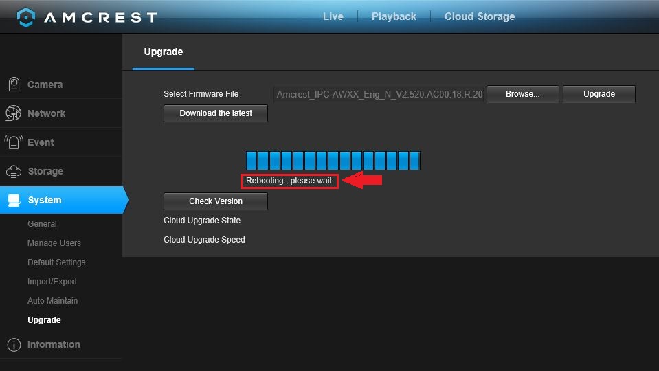

Note: Once the firmware process is complete your device will being to automatically reboot.
The reboot process duration varies camera to camera, however, once your camera is back online you can access the camera's web UI.
