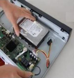

Step 3: Place the HDD in accordance with the four holes on the bottom of your device and slide the screws into place on the slotted surface.

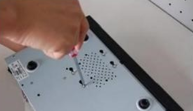

Step 4: Flip the device upside down and secure the hard drive. Use a Phillips head screwdriver to secure the hard drive to the bottom of the device.

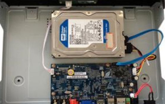

Step 5: Connect the hard drive cable and power cable to the motherboard. There are designated slots for these connections conveniently located on the motherboard. Once connected, connect each cable to its appropriate port on the back of the hard drive.
