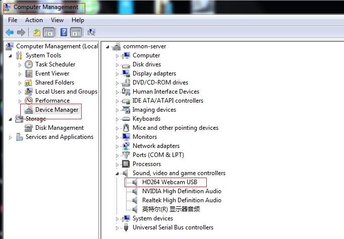

Step 1: Insert the webcam into a USB port on your computer and verify the appropriate driver is being registered. As previously stated, the correct driver name should be "HD264 Webcam USB". Please ensure to only use the driver named "HD264 Webcam USB" for this process. Using another driver may result in damage to the device that you are attempting to upgrade.
To confirm the correct driver name, navigate to Computer Management and click on Device Manager. In the Device Manager, click on the Sound, video and game controllers menu and verify the correct driver is being read by your computer.

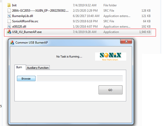

Step 2: Download, unzip, and launch the upgrading tool (USB_XU_BurnerAP.exe). To download the upgrading tool, click here.

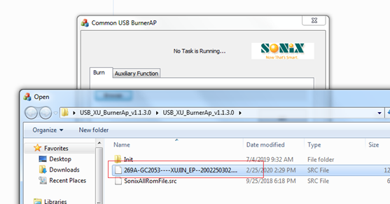

Step 4: Click on Browse in the upgrading tool and locate the firmware file that was recently downloaded. The firmware should be a .src formatted file named "5262-GC2053-(HD264-Webcam-USB)-2005200301-Black Screen issue" and load the file into the interface.
Step 5: Click GO in the interface and allow the device to upgrade. Click OK once the firmware has been successfully upgraded.
