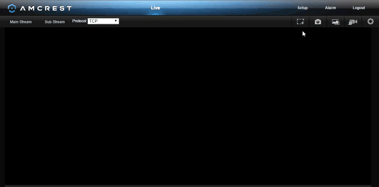

After logging into your camera, navigate to Setup.
Select the Event tab and then Video Detect.

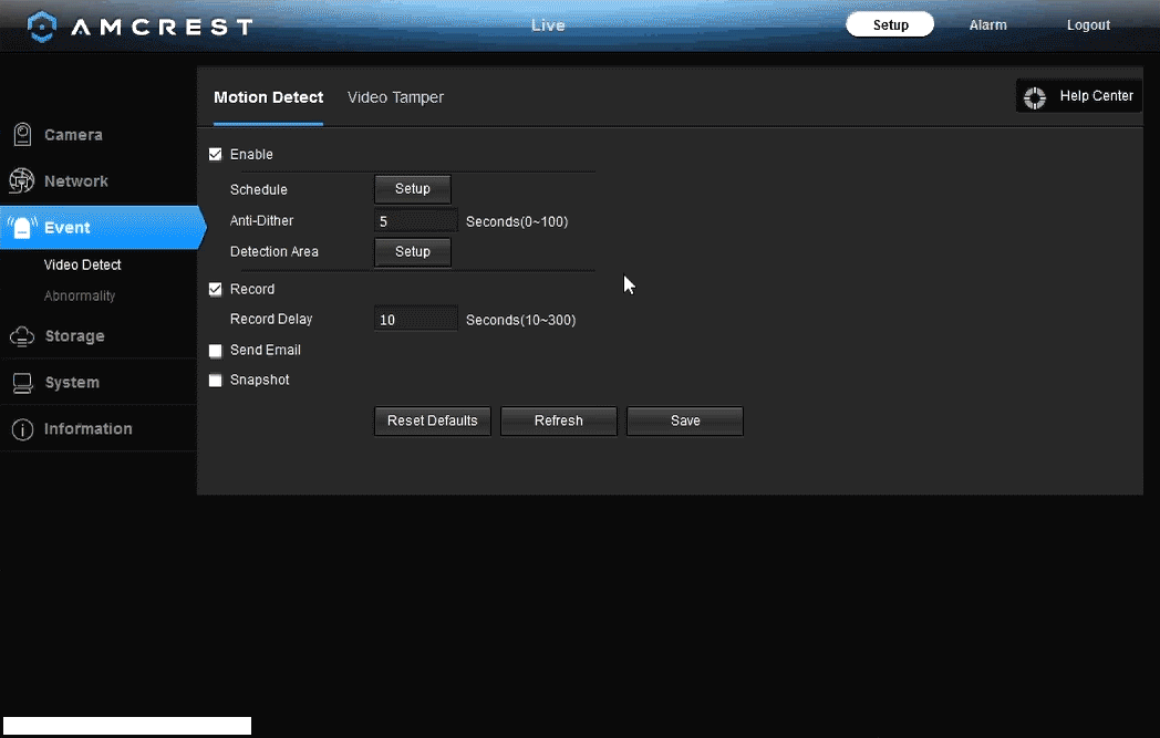

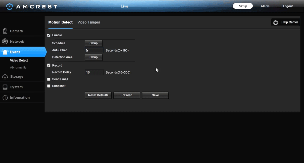

This is the Motion Detect configuration screen.
Motion Detect
  • Schedule: Clicking Setup opens a window where you can create a weekly schedule for recordings to occur.
  • Anti-Dither: This time value controls how long the alarm signal lasts. Based on motion detection, a buzzer can go off, a tour can begin, PTZ can be activated, a snapshot can be taken, or the camera can begin recording.
  • Detection Area: Clicking Setup opens a window where you can adjust the detection areas where motion occurs, its sensitivity and threshold values as well.
  • Record: This checkbox allows the user to enable the camera to record video when motion occurs.
  • Record Delay: Determines how long the camera continues to record after a motion event has stopped.
  • Send Email: This checkbox allows the user to enable the camera to send an email when motion occurs.
  • Snapshot: This checkbox allows the user to enable the camera to take a snapshot when motion occurs.
