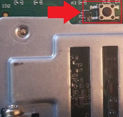

Step 1: Locate and remove the back panel of the camera and locate the factory reset button.
Step 2: Press and hold the factory reset button for about 30 - 45 seconds and release. Once the device has finished its reset process, your default username and password (admin) and settings will be reverted to its default, factory settings.
