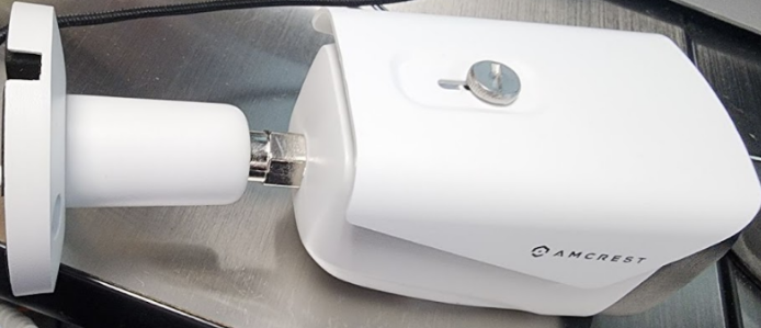

Step 1: Using a flat head screwdriver or similar object gently remove the visor on top of the camera and pop the cover off the front of the camera to expose the screws.

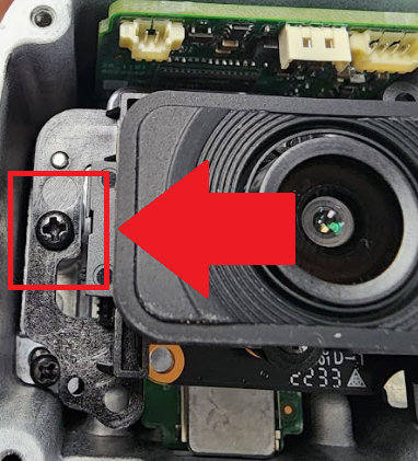

Step 3: Using a Phillips head screwdriver, remove the 2 screws to lift the lens.

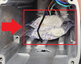

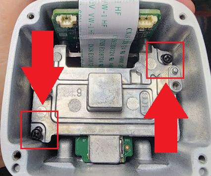

Step 4: Remove the other 2 sets of screws and lift to expose the silica packs.
Step 5: Remove the old packs and replace it with new silica packs.
