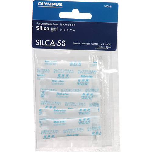

  • Missing desiccant (silica) packets: Amcrest cameras typically come with desiccant packets that absorb moisture inside the housing. If these packets are missing or saturated, they won't be able to effectively prevent condensation.

3. Use silica gel packets: Place the camera and some silica gel packets (also known as desiccant beads) in a sealed container. The silica gel will absorb the moisture from the air and help to clear the condensation from the lens. You can purchase silica gel packets at most hardware stores.
