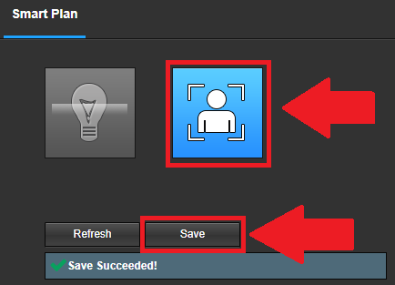

Step 2: In the web UI, click on Setup>>Event>>Smart Plan. Click on the Face Detection icon and click Save.
