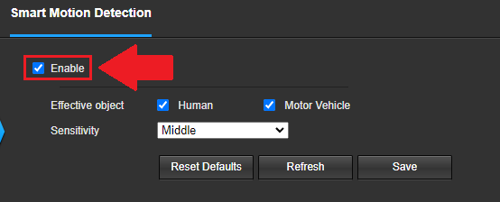

Step 1:Log in to the web user interface (web UI) for your camera. For more information on how to access the web UI for your camera click here.

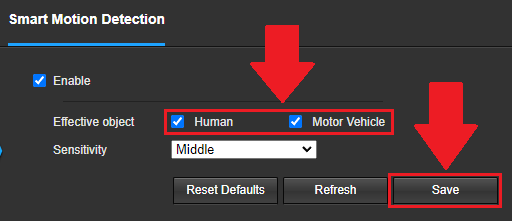

Step 2:Click on Setup>>Event>>Smart Motion Detection and click Enable.
Step 3:Use the effective object filter options to allow the device to detect between human or motor vehicles. Both filters can be enabled at the same time if needed to better detect a motion event, click Save.
