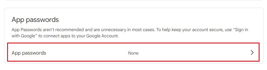

• Click on ensure 2-step verification is enabled. In the 2-step verification menu, scroll down and locate App passwords

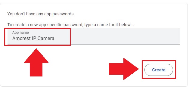

Screenshot 2024-10-16 154916.jpg• Enter a name for the authentication and click Create.

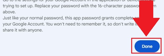

• Google will generate an app password which must be entered into your Amcrest device's Email Setup interface in the web UI.
