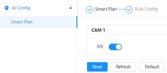

Step 2: Access the main menu and click on AI.
Step 3: Click Next. Select IVS from the Smart Plan menu and click Next.
