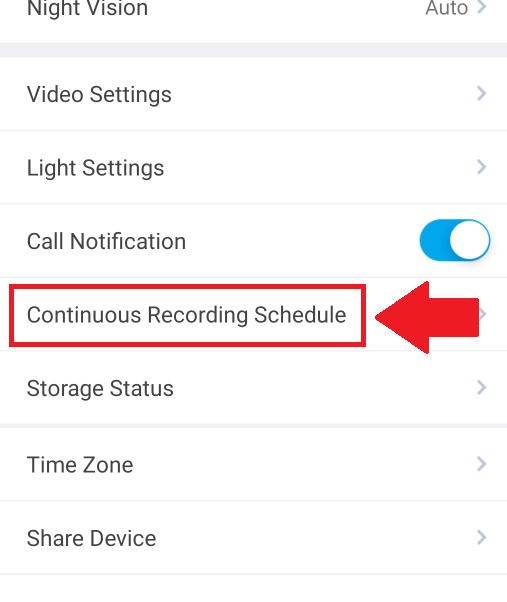

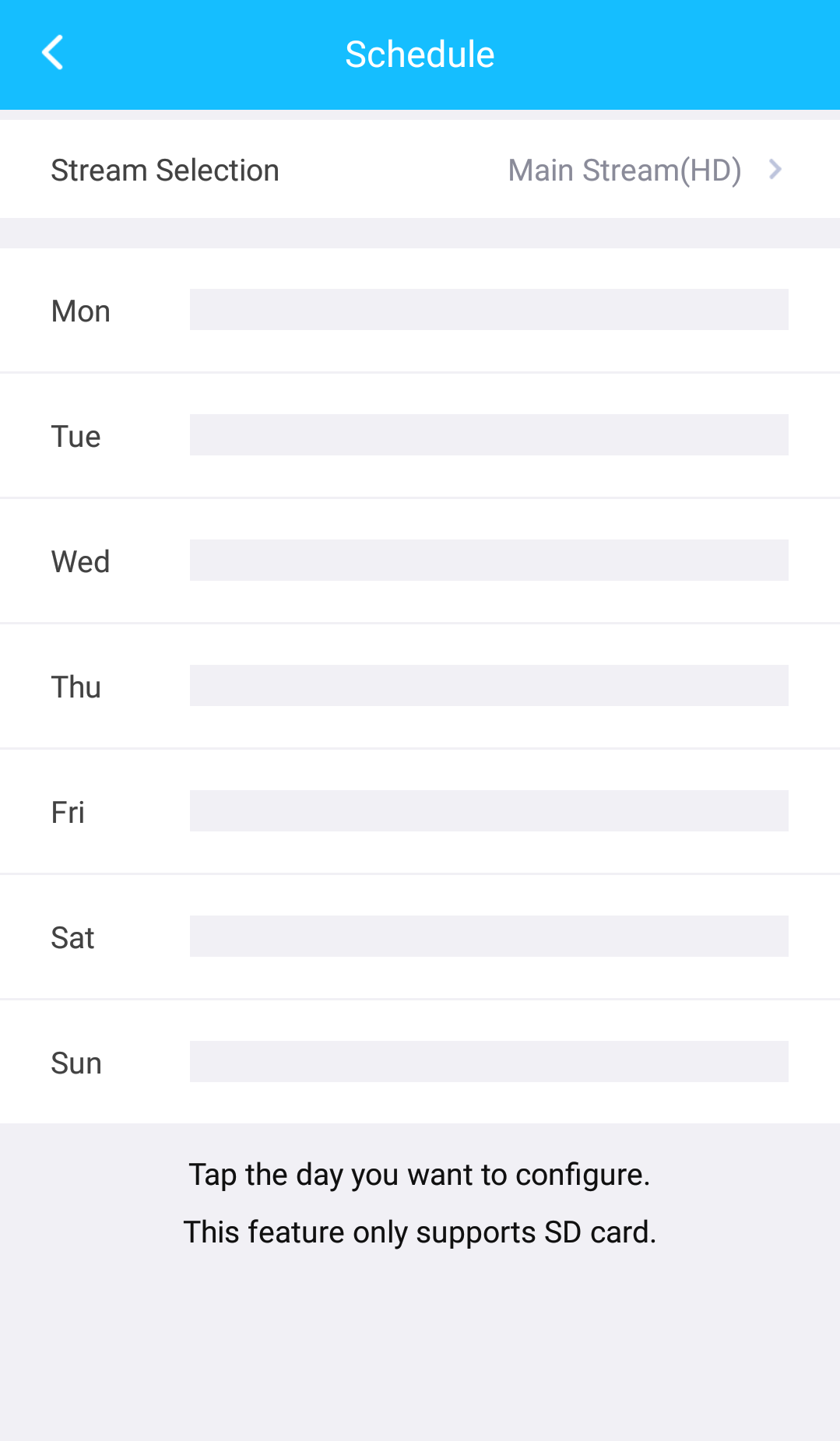

Step 3: Tap on Continuous Recording Schedule.
Step 4: Select the day you would like to configure.

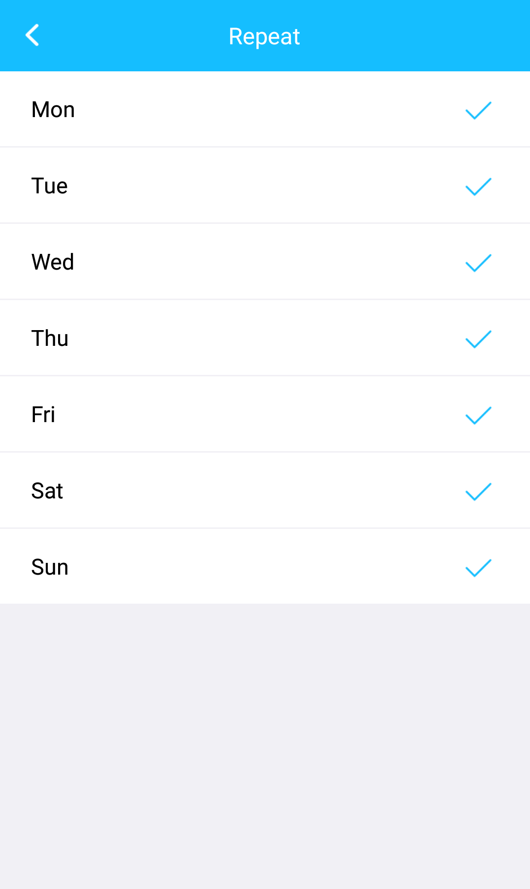

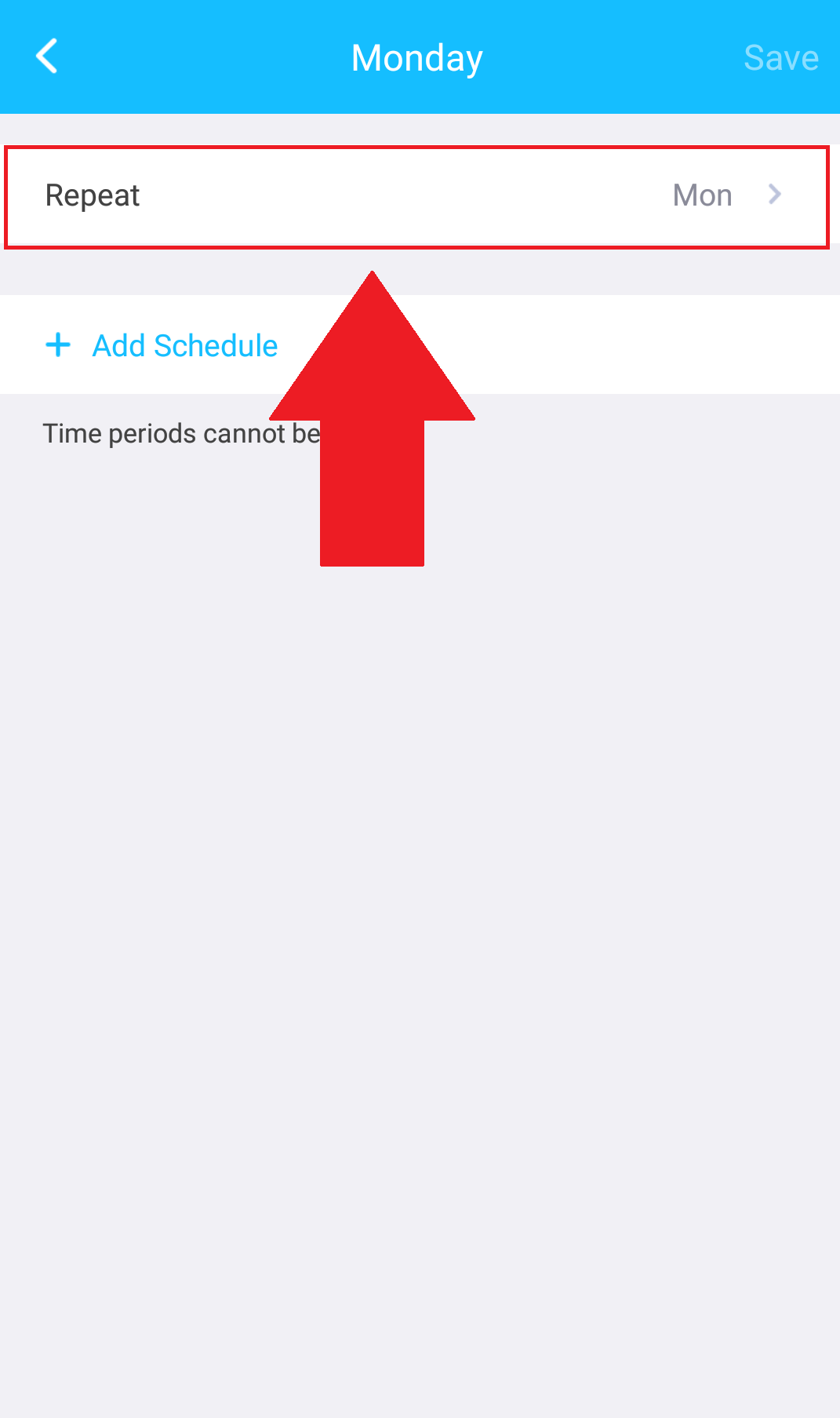

Step 5: Tap on the Repeat option to select which days you would like your schedule to apply.
Note: If you want the schedule to apply to all days, select each day. Tap the back icon ( mceclip0.png ) to return to the previous menu.

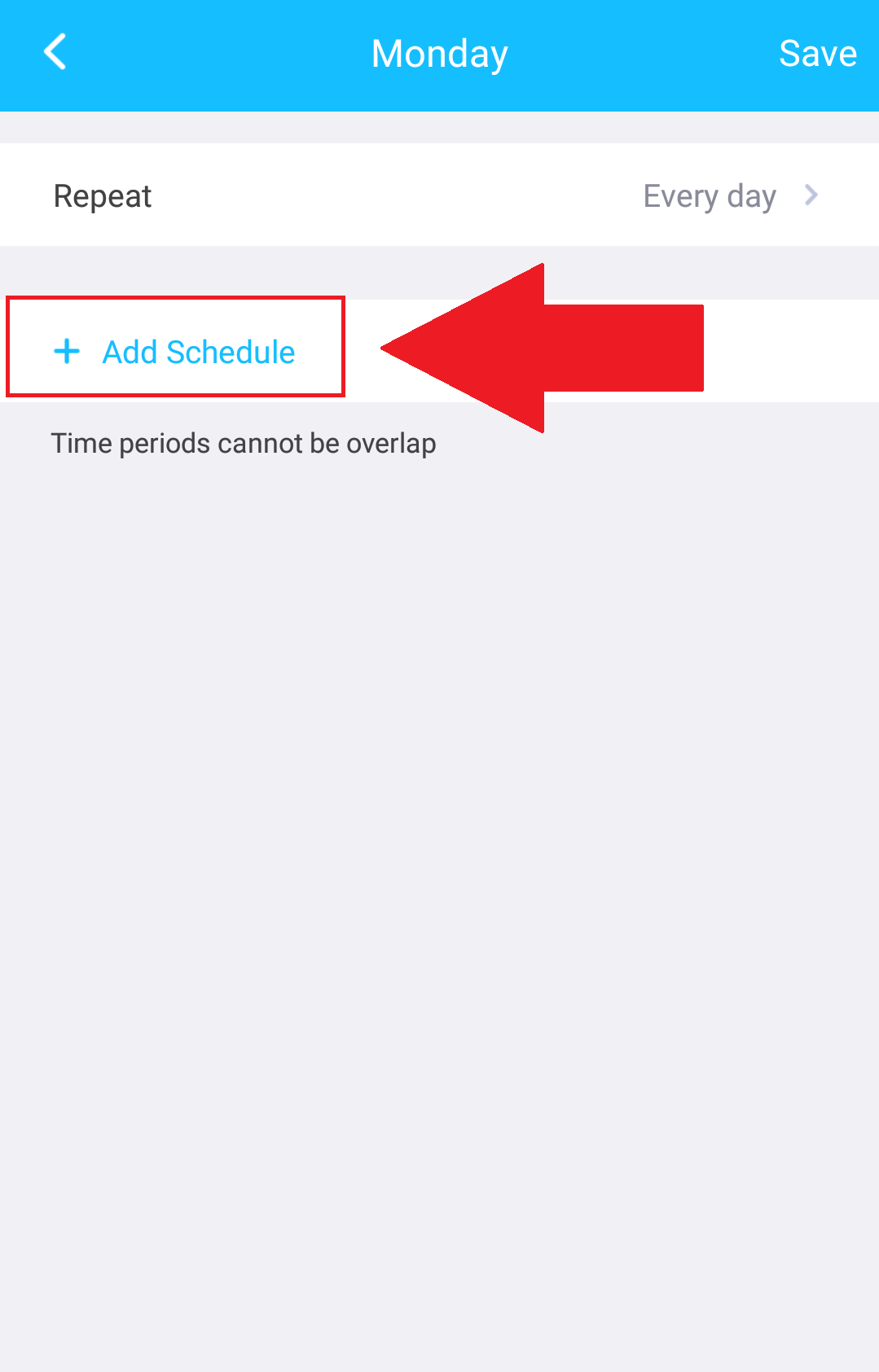

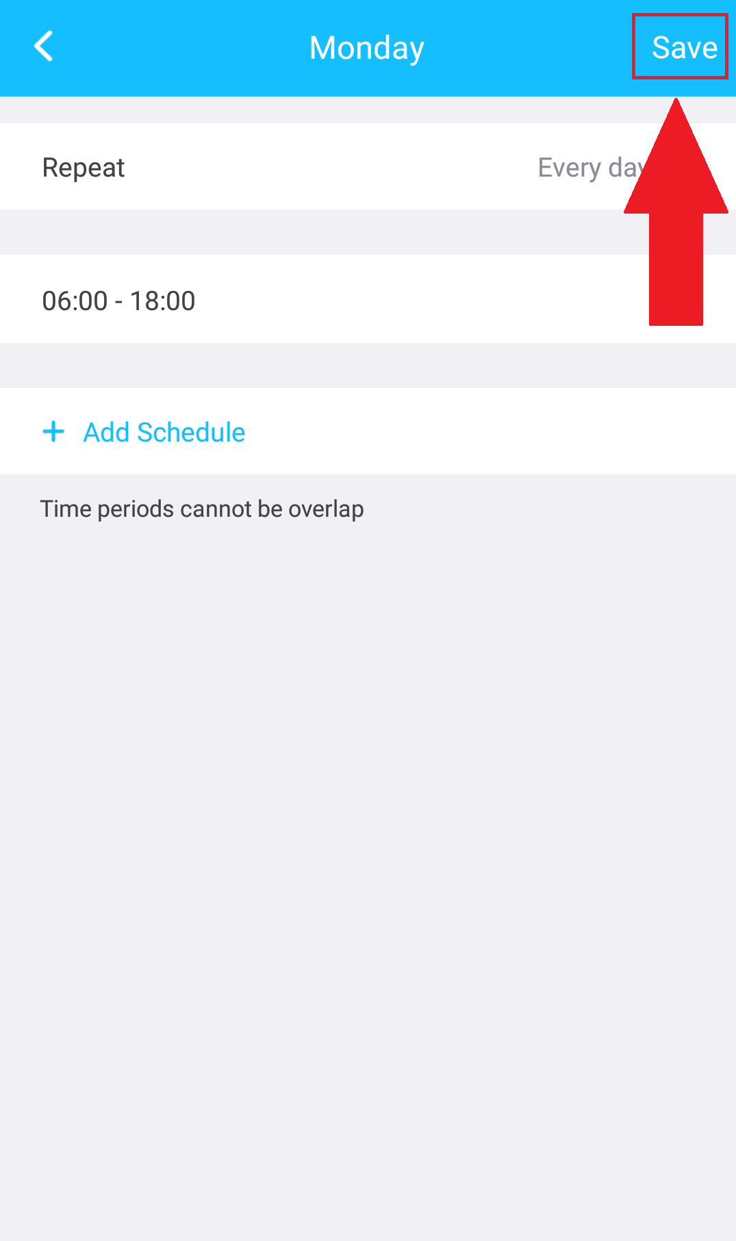

Step 6: The days of the week selected will be displayed in the Repeat field. Tap on Add Schedule.

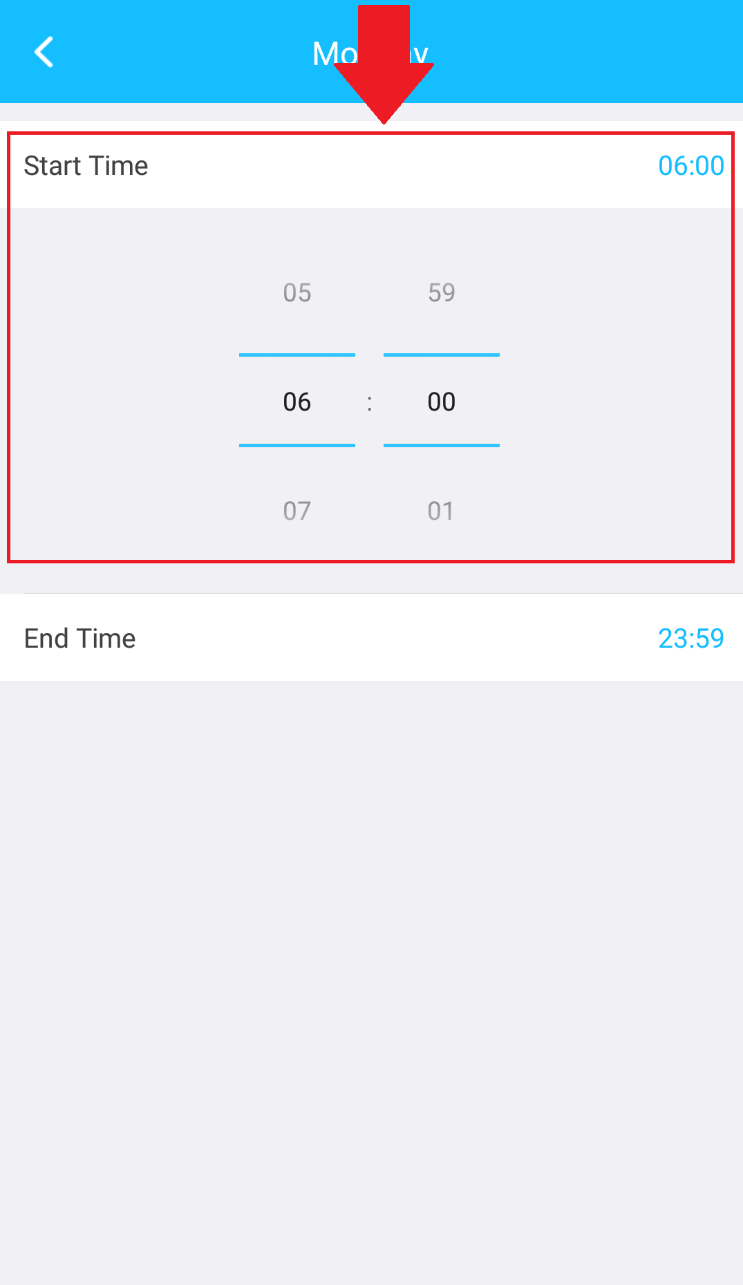

Step 7: Tap on Start Time to set a start time for your schedule. The default start time will be 00:00 which is midnight. In this example we will want the continuous recording schedule to start at 6am (0600).

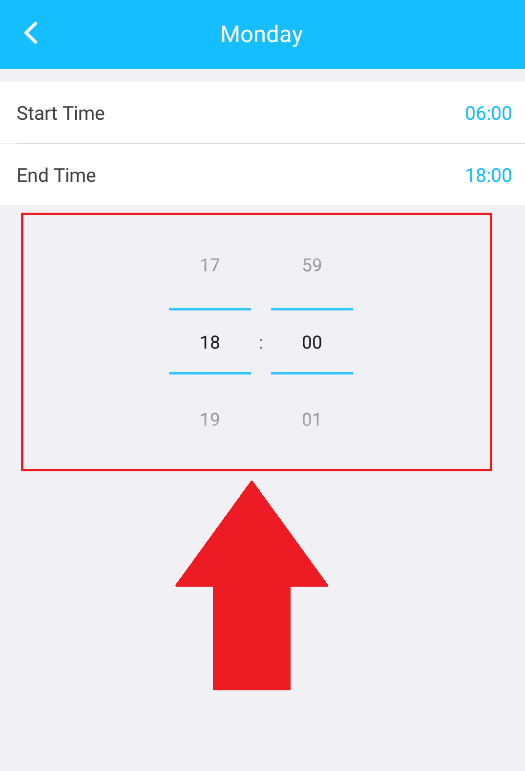

Step 8: Tap on End Time to set an end time for your schedule. The default end time will be 23:59 which is 11:59pm. In this example, we will want the continuous recording schedule to end at 18:00 (6pm).

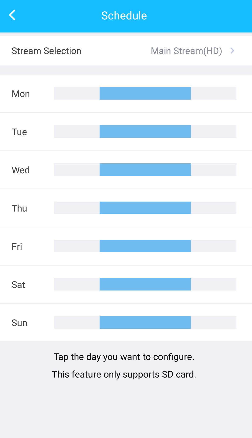

Step 9: You will notice the schedule is now applied to the days selected. Tap Save to save your schedule.
The scheduled continuous recording schedule will be applied to your device and will be displayed in the Schedule menu.
