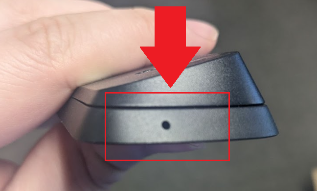

To remove the AD410 doorbell from the mounting bracket, please locate the dismount hole found on the bottom of the bracket.

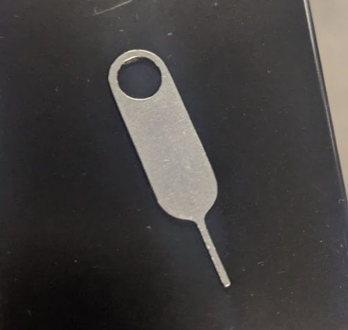

Insert the pinhole tool included with your doorbell into the dismount hole.
Note: If you do not have this tool, a paperclip or object with a similar diameter will work.
Hold onto the doorbell and press up to release the doorbell from the bracket. Slide up to remove the doorbell from the bracket.
