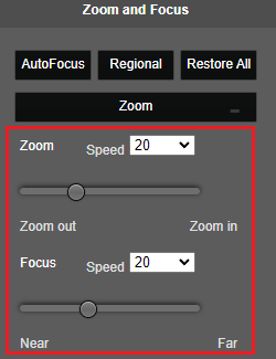

Step 3: Click Live and select Config(LPR) and click Zoom. Adjust the the Zoom and Focus sliders until the camera is at the right zoom level for physical setup.

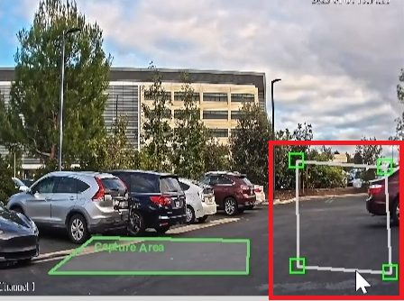

Step 4: Click on the capture area box and adjust the size and shape of the detection area according to the monitored area. Click Save.

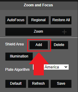

Note: It is recommended to adjust the lens so that the width of the plate number is close to 150 pixels. The capture area itself should be no larger than 2/3 the size of the feed. You can also add optional shield areas that avoid looking for license plates. To add a shield area click on the Add button next to Shield Area.
Left click multiple times on the live view to draw the Shield Area box.
If you want to delete a Shield area, left click on it in the live view and then click on Delete
