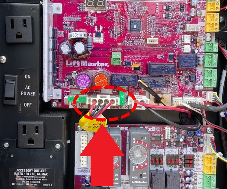

Step 1: Unplug the "BATT DC POWER" terminal. Please note, if the terminal is not unplugged the device will report an error.

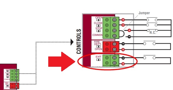

Step 2: Locate the access control terminal on the LiftMaster control board.

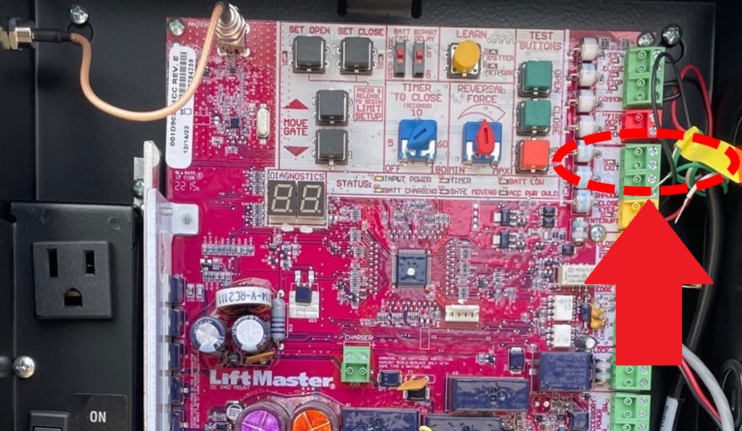

Step 3: Connect a relay wire output from the LPR camera "NO"(Brown wire) and "COM" (Green wire) from the LPR camera to a dry contact input on the control board's "Exit" terminal.
Note: The board can control multiple access devices by connecting additional wire relay output devices if needed.
Step 4: Connect the power terminal and test the relay output device to make sure all functions are working properly.
